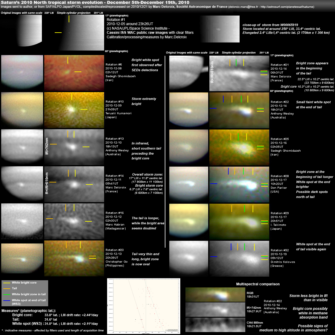

Voici ma première analyse à partir des images amateurs et Cassini de la tempête exceptionnelle qui est apparue sur Saturne:
Texte (en anglais, désolé) qui apparait également sur la page web dédiée à la tempête:
(http://astrosurf.com/planetessaf/saturne/saturn_2010-NTrZ-storm.html ) :
Georg Fischer issued an alert in December as Cassini's RPWS detected again lightning in Saturn on Dec. 5/6th. Question was were would be the storm located in latitude (information not given by RPWS). The answer confirmed what Georg Fischer suspected, the new storm is located in Saturn tropical zone, but not south as what has been observed by amateurs since 2003 and Cassini ISS since 2004, but North! This shows clearly a seasonality effect of lightning on Saturn, as the northern hemisphere has just entered the spring after 2009 equinox.
The Saturn Electrostatic Discharges detected were very strong, and it turned out that the storm observed by amateurs was the brightest feature seen on Saturn since probably at least 14 years, very easy to image by amateurs and even visible on individual raw frames!
From the single Cassini Imaging Science System image session showing the storm at the very beginning, the storm rapidly grew more than 10 times bigger, so spread in latitude that due to the difference in wind speed upon this latitude range it probably left a long tail preceding it.
If we consider that the very bright zones are associated to lightning, the lightning zone is now very spread - with even maybe a white spot further east of the main zone.
Contrary to most of the previous storms observed, this one is brighter in visible wavelengths than in infrared.
That is a fantastic start for Saturn's 2010-2011 apparition...
Allez, à vous de jouer, tous à vos télescopes! ;)

Que devient cette tempête visuellement, de plus en plus lumineuse ou non ?
Si la météo me le permet, je tenterai de la percevoir avec mon T180, ça risque d'être difficile, à voir en plus avec les éphémérides pour que la bonne face du disque soit visible !!
Désolé pour l'anglais, mais c'est déjà beaucoup de travail, alors la traduction en français en plus, je m'en sens plus capable :(
Effectivement la tempête est étonnante, elle ne faiblit pas, elle s'étale en longitude, tu devrai la tenter ...

Pour moi c'est super que je l'ai capturé par chance ce matin avec ma lulu de 120 ! Regarde mon poste d'aujourd'hui et tu la verras. Merci pour les infos mais apparament d'autres astronomes avaient déjà vu une tempête sur Saturne en 2003!

Franck, les amateurs ont observé des tempêtes sur Saturne en 2004, 2006, 2007,2008, 2009 et 2010!
Je pense même qu'on en a observé en 2002 et 2003, même si la sonde Cassini n'était pas là pour vérifier qu'il y avait de la foudre ...
