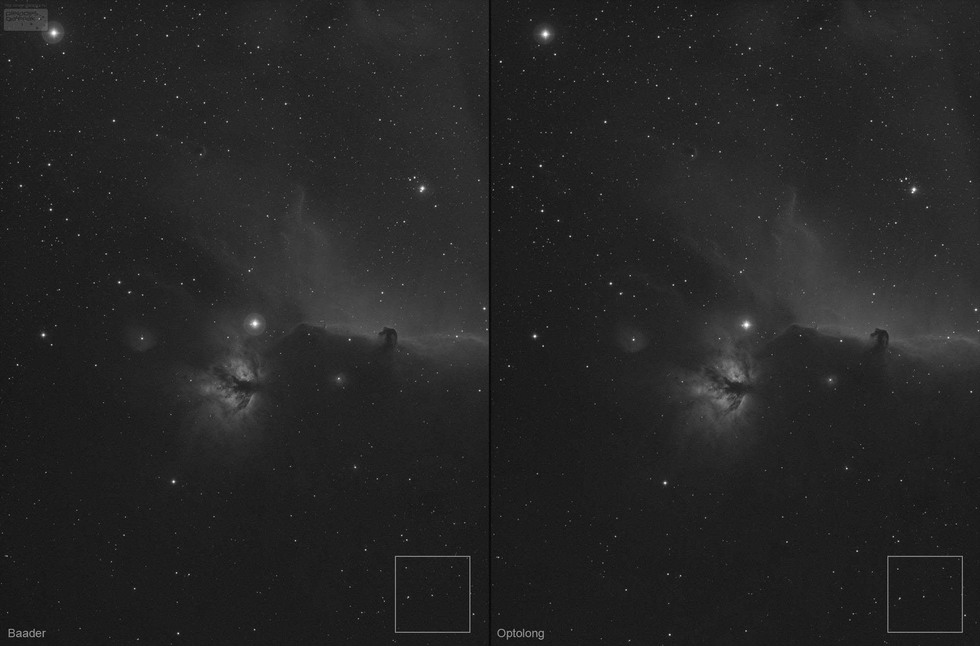

I made the same processing steps for*the fair comparison: dark, flat, flatdark.*Grey box: exactly the same area, same luminance values (C: 73%, M: 67%, Y: 65%, K: 80).
The signal-to-noise ratio of Baader HA filter measures lower contrast.*The halo*around the bright stars seems to be much more softer when using Optolong filter. I placed the more reflective side of the filters point away from the chip (on Baader filters the V marks the preferred orientation). *Of course it is not a general rule and it is not only because of the filters. It depends on every system, for example in an optical system that put a lens or series of lenses close in front of the filter it can cause reflections. I have reflexions with Baader and Optolong too but the difference is visible.

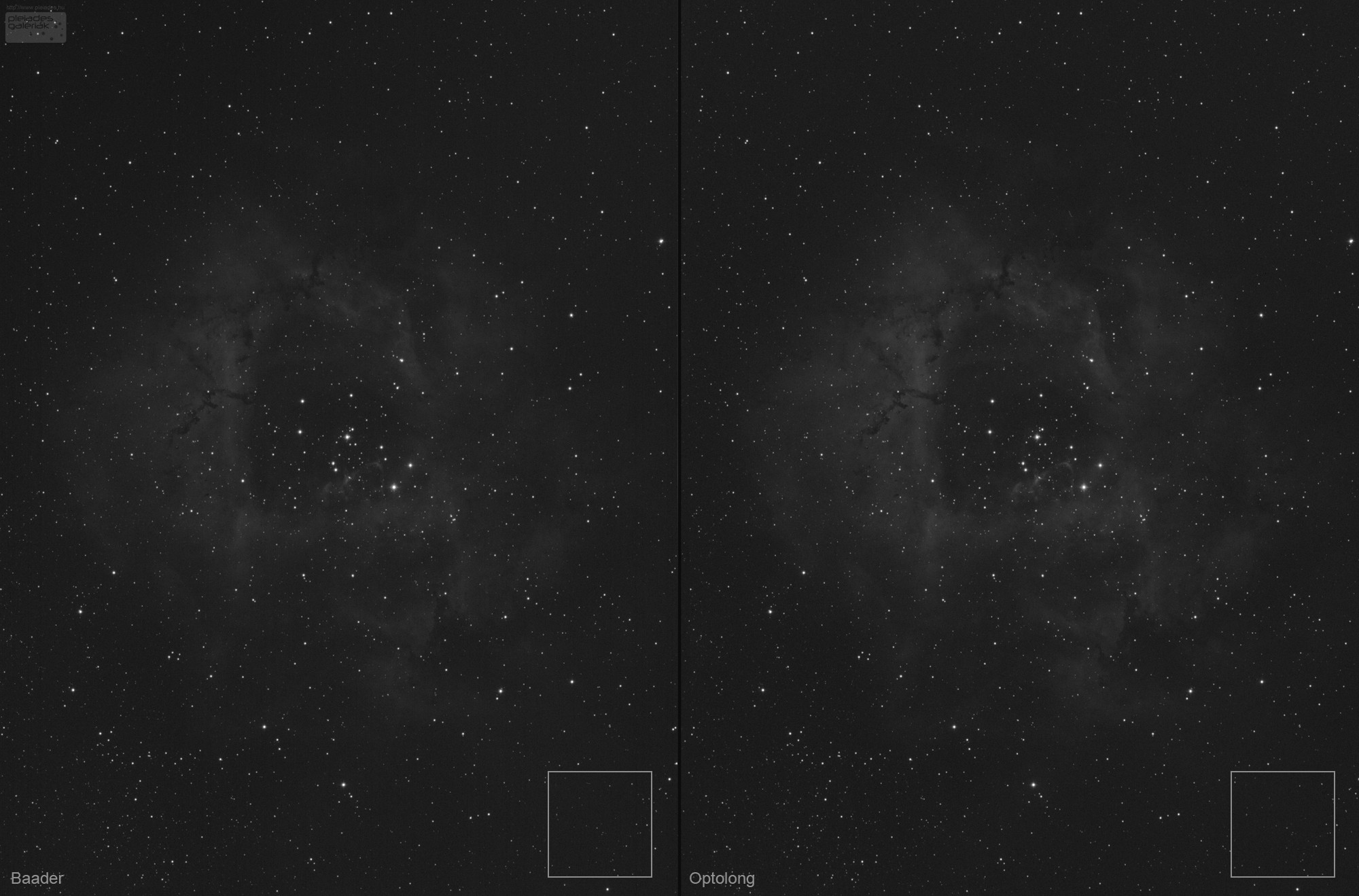

I had hard time with bader OIII since it results a rather uneven picture. It can be a major problem when dealing with very*faint*objects (there is a strong need to use the “curve” command). So even with the finest pics it requires lots of post-processing.
On the other hand the* Optolong filter shows* better contrast.*Since it does result a very even background it is easy to process images

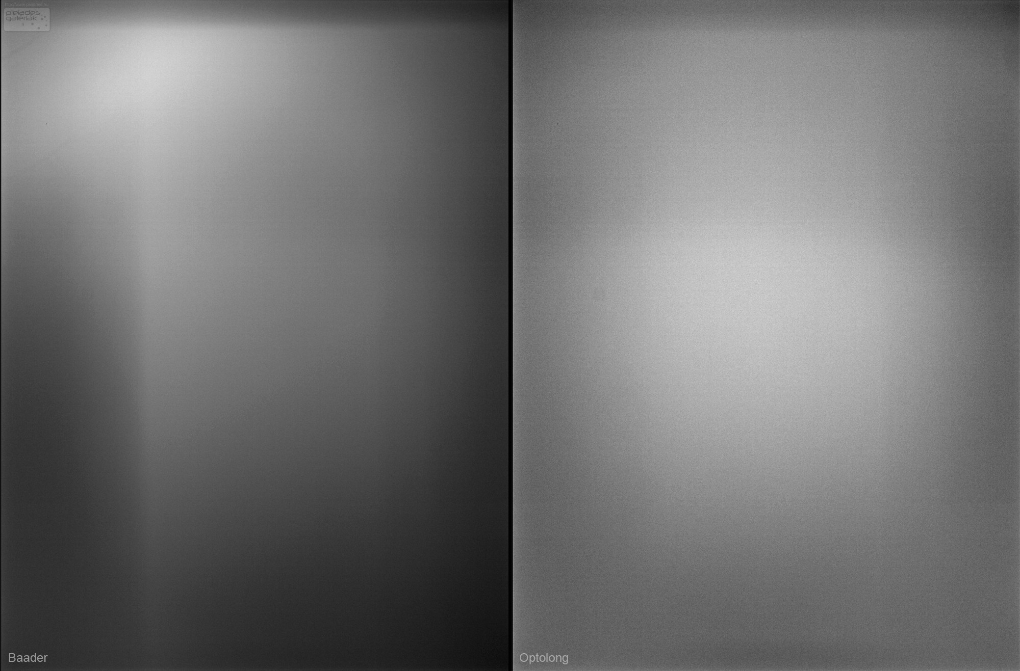

Quick summary:
It is a big difference. Optolong filters have better, balanced flat.
