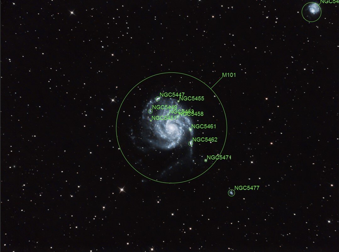

Shoot N°22- "M101", EQ6R Pro - EOS 6d - 800 isos - 250 PDS - Astroberry - 3h15
