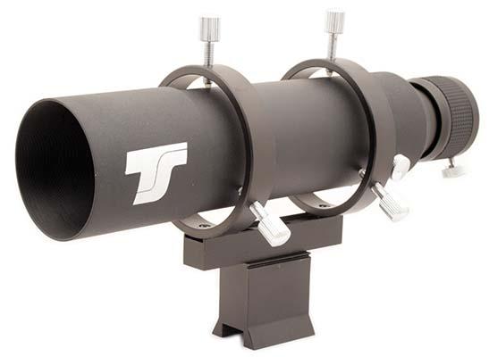

Perso je prendrais l'autoguideur de chez TS, qui en est monté avec deux vrais anneaux, un pare-buée et un PO hélicoïdal. Il fait 205mm de focale et il est plus léger. Pour le même prix... ;)
http://www.teleskop-express.de/shop/product_info.php/language/en/info/p4064_TS-Sucher-50mm-Oeffnung-geradsichtig-mit-Halter---1-25--Helical.html

"Hello and thanks a lot for your request!
Shipping costs to Reunion are unfortunately pretty expensive. The cheapest shipping option is by post and costs 46 Euros.
The finder TSFRE850SS costs 74,79 Euros.
Unfortunately the finder does NOT have enough back focus for use with most autoguiding cameras like the Synguider. There is an error in the product description in our website I'm afraid. If you want to do autoguiding then you should rather take the normal 8x50 finder and the optional T2 adaptor:
http://www.teleskop-express.de/shop/product_info.php/info/p295.html
http://www.teleskop-express.de/shop/product_info.php/info/p4708.html

Ouche....une autre solution pour porter le synguider ? (si ya le meme chercheur autre part je suis pour...vu les frais d'envois)
