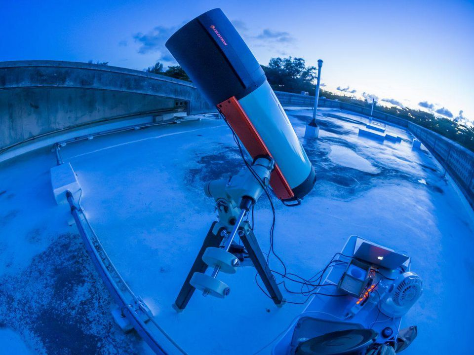

Un Astéroïde découvert par des scientifiques japonais , par la méthode des transits, avec deux C11 rasa.
L'article complet ( en english)
Un autre article sur ce sujet :
https://www.skyandtelescope.com/astronomy-news/amateur-scopes-help-find-planet-formations-missing-link/
extrait :
To extend the search toward the rarer, larger Kuiper Belt objects, Ko Arimatsu (National Astronomical Observatory of Japan) led a team in setting up two identical observing systems using off-the-shelf equipment. The two setups each included an 11-inch Celestron astrograph, equipped with a ZWO ASI1600 MM-C CMOS camera, on a Takahashi equatorial mount. Combined with a focal reducer, control computer, and data storage, the total cost of each system came to $16,000 — relatively cheap compared to most professional Equipment.
