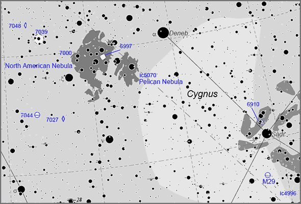

pour le fun voici un comparatif de la même région du post 1 autour de Deneb avec Deep sky atlas, sky atlas 2000, Taki, TriAtlas, PSA, Uranometria, Cambridge double star atlas et le Royal Astronomical Society of Canada
Deepsky :

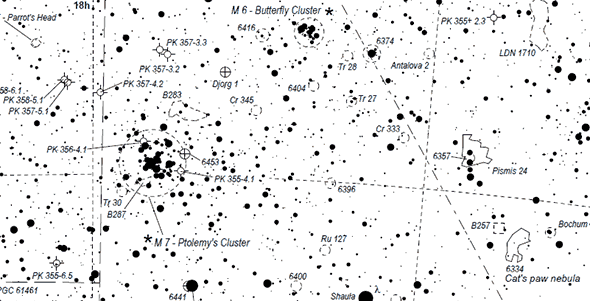

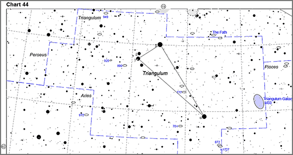

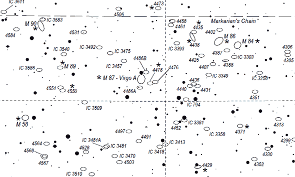

Après le Deep Sky Atlas, voici le Deep Sky Hunter Atlas:
http://www.deepskywatch.com/deep-sky-hunter-atlas.html
  Citation
New, comprehensive deep sky atlas, designed for serious DSO observers.
Magnitude 14 DSO, magnitude 10.2 stars, 101 pages (entire sky), 21 "zoom" maps.
Indicated best objects, dark & bright nebluae, common names, detailed objects list.
"Deep Sky hunter" is a printable deep sky atlas, designed for serious deep sky observers. It features stars down to 10.2m and DSO down to 14.0m.
This is my second release of a deep sky atlas. It is much more detailed, and covers entire sky with 101 portrait oriented pages. Manual post-editing was performed in order to ensure readable and non-cluttered charts. In addition, the atlas features 8 pages with 21 supplement "zoom" charts of galaxy clusters and densly populated areas, and indications of over 500 best objects (Messier, Caldwell, Herschel 400, SAC's best).
I designed this atlas with A3 page size in mind, however you may find it usable on A4 as well. In terms of scale and amount of detail - "DeepSky Hunter" falls between Sky Atlas 2000 and Uranometria 2000.
Features summary:
* Stars down to to magnitude 10.2 and DSO down to magnitude 14.0
* Comprehensive manual post-editing, resulting in clean and readable charts
* Select galaxy clusters and dense areas plotted in 21 "zoom" charts
* Indications of best DSO (Messier, Caldwell, Herschel 400 and SAC's best)
* Common names, bright and dark nebulae outlines, galaxy clusters
* Easy navigation with double page spreads which cover 40x30°
* Entire sky covered by 101 charts and 8 pages with appendix maps
* Index maps, "neighbour page" and "zoom chart" navigation marks
* Constellation lines and borders, RA/DEC grid (epoch 2013), double stars
* Printable appendix of detailed objects list and best DSO images available
Euh... c'est du lourd!
Les cartes sont bien lisibles, les principales étoiles ainsi que les DSO remarquables (même les moins connus) sont accompagnés de leurs petits noms.
Trop complet pour être imprimé (je vais me contenter du Taki 8.5), mais un atlas qu'on parcourt avec délectation (sauf que j'ai certains cartes qui ne s'affichent pas chez moi, comme la n°20 par exemple).
