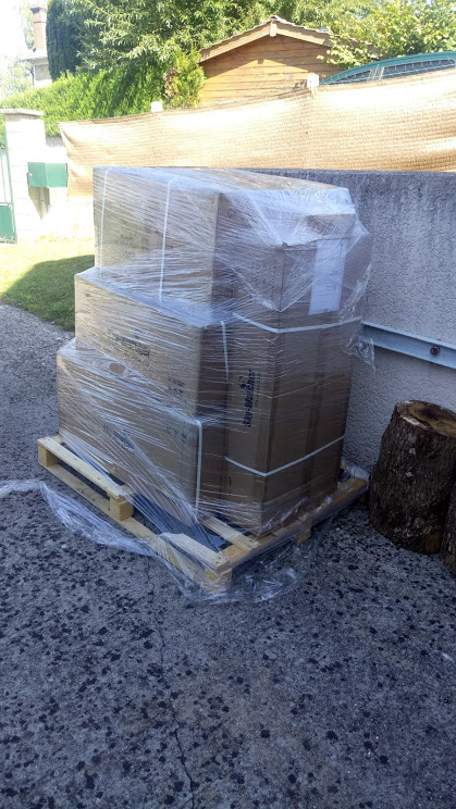

  • 3 semaines plus tard...
ding, dong, c'est le livreur !!!
ufaDdSE6e5rd2KwL2WpQ5ZSeOyCk0m3oCMylKYOby6IbKur2RpIIsCv_TK__0hUMCF0U8ZFoqsfv5SQvTXtw-OMGUkSDXQmtDXKy47NPHQEYHNrI1OgRwAney2uFC5ysCiIvqVhJ2lSjE0Q_Tn1Pz3S0rvQQr_n5kdBorDwwrcHDynbIRHtmM0sQ5AlvRmxt2tEBUUf0z2Vu4JvRbn2R8QgtVowJLwfIFHshrTm-8p5999egGc5k7aXBn0fSTjPU6Y8HZdOvhfkeWQwuwGm0gZ_KKFWrN3g_BzTuO8c7sa3afBCLwmn68l7H-jKtohT3usy3nIb2SnGo7-OH5fQZi4RBxx9rxJRDLJ2asbl7jFs-Fm2cEu8H8gZFUr3SDDR0ovxElhoJViK1wjLAZ0rDeu-ud-HJOJyqkvcNvQ6ZBGeUXIFEYTodUzv_JgaeVk3RYqnN73L3Nb00oeStJqIRiPf9_9luYMryMLBJNKqQzo45Akb9f1usrCVRmFipx_W7kiVK5486x0Ow9Jr6Qel9GsID8qi8RufaKghTueZ_lvgoqlxzQMB1HyE9G2C8T6zp9pBFB8TxLrD0-5j7OoVkBvS8qUOSZzxS9khh9nI32AkQicOyYH1tCogqkW2yl9s_wet0RkdaqqyN6_bcMOrboSOJrT1n10DtRgAcgxcVPy4bo2g=w420-h744-no

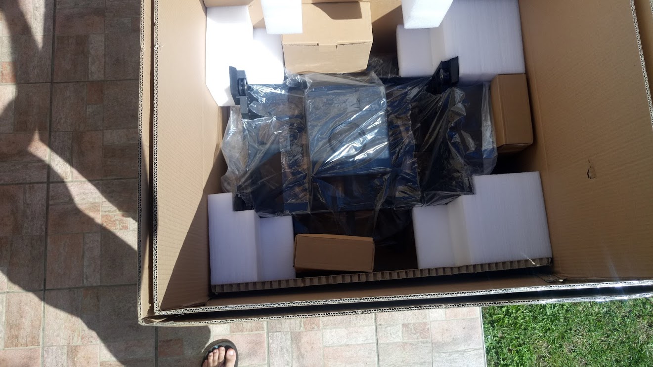

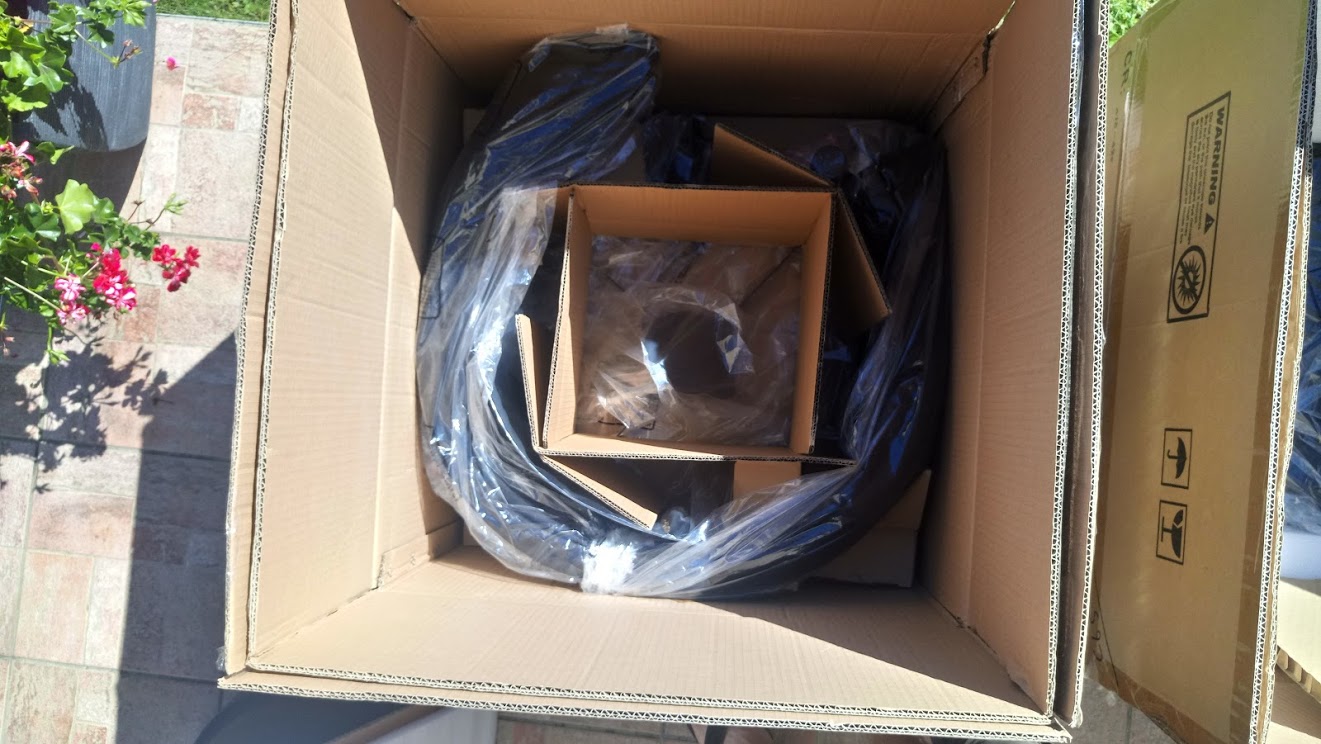

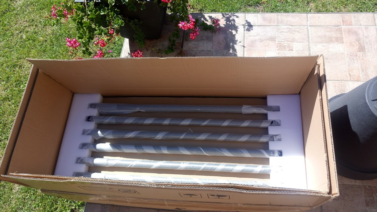

Ouverture des 4 cartons:
f6zAFU_xlNP7om1VpYl6zfUy12_td9ScRJxNPMUMgsTIT5-9REJ8cp63h-aLCcqs_V-0bIql-IDz4tcj2ak34Yrzw9loDoBdqwDecrTWF87rczetPomLmPArE_7FvyUt7A9YcsQ9Bp7C3TSFV_fYpdDJGipIXT55JDiOrxbWyUXap94iZCikqcnLL8MTH2eQFejrn2W3Cs2StyhEXYIDhMrVzEQdo6EfTRuBeqCEWi2hMBBbMf-7KywRjTW_850wVoKozGR3mXxGqLw0H5NzBQ5rVs1D8ETQSGfY0Zim9CQdvR8tM3uktU__o0bJio-gsPye3jLYj70vii9-vvh9PzenBek5n0kkigU8uJtqQI4TVIz2mTWgeH_aof0iREqt9m7ddgPZP9xlghAZYE9kbhRKehkL2VL0GAxR-YhsiwJ_S38QQyAidL68zpdcne_8XCI9JoM7WYY4IHg-Ffx6CJ1Tx_G0GpTEG5o2KtQlTjuFDuTtYclovrMlLxs-TlAjvt2lyUeev7-354EapU9P2iuchXnRHjAyCfcctJqny7dYpmDgKqzjjf64jW5GHag3OEProHQ0Usm-eqb3oWqRE8yY7CFW7c8TJlWf97q61Wpa9mVhfXa-OU_y6GeM2Aw8dlKv5yVC7rw7ChtD3tSdn1yJpJD_W1D_1rXr-3Gw5X1Sk4k=w1321-h744-no
U0qUbICwobx9XSdkjceluSvtRXWFnmzFPVhb8z5RRNUcC9Oae4QaHRx-zsQQPTvYoVNQ23rJfe_hH--7JdyXgn6GufQwuqjd9k1s6Iqe6SvxbsefVkdVAAnFVpJy2rTbQhrdhlCN95IqfOHsffk4hEGRUQDwsiJ4ekdZ-5zaufnR1b4-3h8YuJT8Pcs5qMLGPOl-wPX5ed8icYLdK2VUY3g4PnIaX93U46E1Q9Evg4Xy3EZuwERYKt8pMF5DADNNhXG7-08tO04XYdQcPvMsHeL4av5Ss4URwoeYjroAmkNXlXwSHQ2W9tHc1S09Z_xmrrrI561DcjvVtt6AuGcRu5za3qAJXv2vksbiWMtPQsLPK0yY6vNBNg0TaWpIa3Xux5Si4-ByTfGHiRMkREi9KUYv4oNWt5_AhZ8iV7Nw9FSjT-3SSSetaC4K5bvr1RSYDv2CbJuaXtSFC3wBAkyB5ABdkEfpSYh_uAFKAYqUIQFaut70Ph5w4EsDUlbITge9TVG8C3P8Xlo8sAOJPZ9ZZ7TVDHWO69JAcR_04OSFPephX8bixSftOixWgE__7lmwD7CYyJX3QYMZY_OVL2Ggrpf0zGRLDLBcesvCYANatSljHosW251lyboMgVy9JZfAKafWmvkCw7dB6-JrXLDmC4ljQudKsTZu6POLqJp_Pgrfn7Q=w1321-h744-no
DUC_zjzH02ZPw-I8gyBbhaxmIiVoNy1pEBroaj0jMvfdKH9qvjFmjmNItZGq8IWubzrJpmPqhXOy_z8bqM5BwaJI2XvdWSd3pr7EFn8Zx29KniLEQ9Rna32KTTybiEG0nxaG3Vvf4wNhztDYBFQJ5MQG_lAVUmoGAmHwlBR9Cxl4oTFjLr9OGFsbR-FYE0unIzVVMfmPFV2LaY1pBr6njG_wE1qHlPQqQ00AbbxzIPv7kKq5rizcsbGU6rsZAyjWYIWK1jEI95vLvkksHmlL5_36mSwtkUaQp-GgI7a-p6_Jx3E9akQWAn6nkOhjYIB7dfKKblQ6p_ny4LErkh3-npSSrvvBNmHojifVdXks7mNHLxfY7qAPcViNEuN7IOFLjPOJhv0nsL6oC78bkzW1bEiu-qvojlZRlSDHZM1WQFj8_SEOmnQ2--5oibMJ3kVgMn1wSUwxIX3f7muv6YaJUcfdHjrn-DfEuZP2Q8ljiiFMPiScrlSb-IKAC7GxNLNG0vZUmnGy74mjvQrtf-ly5IpjsqeD8bTwuoV1BAf7TME4qFB-DXRAbUJGEWHIapx5AM4cTMwhUfpMWORQOXnvhOaVW7btSdmcn3f6-S7ncTWKy-iz-4G72_2E_Y2eGyyRqe_OeqBpa_y5-Y3HC-3fgpT7ke79WjMQCi3xmOrsbFDoU3A=w1321-h744-no
Bn81f2aOSE_pCJDBwapXrWMaHQLMgmIgS9xE25EF_HK8u9Izmgev1_Pjjy3rnce8-RWyXZfVukqpU5d25Ps-HN3tu4LnVgFkcZv_-Jm-cysRpO-JmdzgHYz00z1PR1lAe5UeMX6vckzjMTxnT6JS3OivUl2jS1vT6HMWjgDV66GRyz2FWMscu044-8PvtV-h0dWQQg2dGlCqDpPsDPZ5cPJpiuzoVH4objnqWb8bOjYtMY71vWrVPJO184xNzgsiFs3JrWG0aFcyy_DyVIJ_vsm_0ne1KLInIR4pKs1RLdsFoYB1uaqVA8vCfnhcuo3xOgeGwSRUIy_2yRt1H2nXhe_UBOXseRjCQvRJWtOV9I8FPUo1nyBWvc0fEd32SIfqurV6wdiZc1BGxPn6BgwomXGTETAq4iwMHXnQdDY1ML0hddUZJn8FULVcg_q4sghONKOG_hKlAoscNJlQJdsKWLEZgudR75ynHUYI_bNlzll8rhekzKqnKWn01St4MTb_ZW6oY875pvR1h5Xe76EiYnUpyxbcrABvsFScc0zttP3h6dV-0SkEWeBinRsyXbwVDpRGDgXKwXXsm8p1BJiBvDRr9aYFlF5vvl2XpiFJgvv_rcxSBaZUaiK7U9LdOu4M-aT-4dUMcHXXMAg0EnUlKlbQGnZTujcxnR5ervk695qA0Vg=w1321-h744-no
Comme vous pouvez le voir, tout est emballé dans 2 épais cartons, les pièces fragiles calées dans des blocs de mousse.

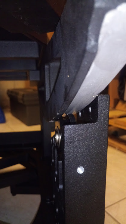

La cage est plus large de quelques millimètres que le support du rocker. Direction la caisse à outils, je dévisse les cales en plastiques coniques en haut du rocker et là, c'est le bonheur absolu. Il est parfaitement équilibré, fluide comme tout. Alors me direz-vous, je n'ai lu nul part qu'il faille retirer ces 4 cales, pourtant elles font provisoires en plastique bas de gamme, comme si c'était pour le transport.

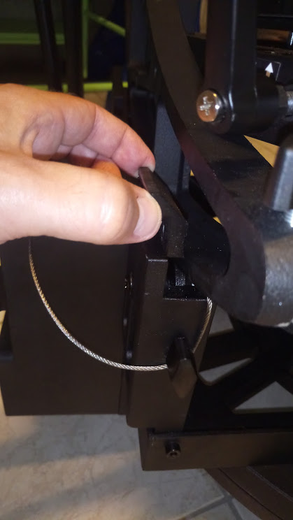

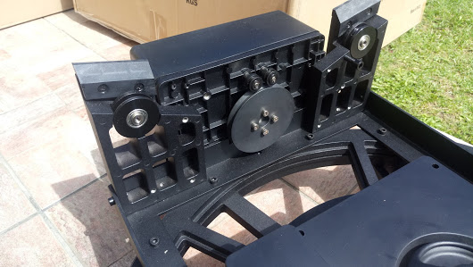

Hum, à mon avis, les 4 cales en plastique sont sensées empêcher les tourillons de basculer ou de glisser hors du rocker. Ca doit pouvoir fonctionner sans à conditions de faire gaffe...
Il doit être nécessaire de forcer un peu lors de l'insertion de la cage du primaire pour que les tourillons arrivent bien au contact des poulies, car les cales ont un profil en forme de crochet surmonté d'un pan incliné destiné à faciliter l'insertion en force.
Les 4 cales vont ensuite les maintenir dans l'axe, le profil en forme de crochet empêchant le soulèvement.

Les tourillons ne peuvent pas glisser car ils ont le profil d'une roue de chemin de fer. La jante du tourillon est parfaitement en contact avec les 4 roulettes. Il n'y a aucun jeu entre la jante et les 4 roulettes, tout l'ensemble support du primaire reste parfaitement dans l'axe. Si je ne supprimais pas ces cales, les arches ne touchaient que d'un côté les roulettes, et frottaient de l'autre côté. On dirait vraiment des cales-frein provisoires. En tous cas, il fonctionne nickel en altitude, que du bonheur...........au fond du garage vue la météo par ici..........
Je reviens sur le soulèvement, impossible à mon sens vue les 45 kilos de l'ensemble cage primaire + tubes + cage secondaire. Et le câble d'entrainement qui ligote la base à la cage du primaire ;)
Modifié par Captainboeing
C'est bizarre quand même : les tourillons sont livrés démontés, donc je ne vois pas ce que les cales sont sensées retenir pendant le transport.
Maintenant, peut-être que ce que tu appelles les cales que tu as retirées ne sont pas ce que je crois.
Voilà de quoi je voulais parler (et je me rends compte que je me rappelais mal : il n'y a pas de forme en crochet, seulement un pan incliné pour faciliter l'insertion sur des patins en plastiques dont le seul rôle est de guider les tourillons latéralement tout en les empêchant de frotter sur les flancs métalliques) :

On parle bien de la même chose !
9G7krPmoNA6LuYxJG51tftYkWMD7G0255GTyI7bXzJqHUPYrWS1xE0uNBcMKh94NTLGFYb-PqAO3htGgRVqZTHCovclAcSZd3eYBjWwJM3k4XgbnVpc5CQMBEbLboIqj_4DJ5ofR9wrpxLDLGMDqKMlOcTDPuCJwOSO_QweEVT1EON7ww4QI1QCs_MHXKFmx8vkkopG9oiLz5vvY4lBKREnHsjCj57VU75Sw3V7zjS_PSgPgyFwMEv7-bj4tgucT3sZ0G7PXqgErYBGfN1Ah4EY1IrzctpdnUojqSFI1N98R5nHHiiKlX41kTVKFBdueM-YAjUm3YHPu7sgrExl0JFgiO3Hn_Su_keMaBbjnsb8eCfJhGdABiT6-Q8cW1IB5waL1dI_wIgTLEFIAsu65xBv6GsinrKR5-Nyh5Yxwv6YVK4gI11EPPEOEMAE77Uy7B_5DAHFdkud3aIhR2PDuMFXnr51YoeHxcqs1doWtgDZgErRP5YKD66uy_hvJvzWEEclPFILp3eGkfyKdfYmDkJgTzU4K3rs1nuniAonamSWzG8K80pEluVz2_OTgoDC2jB6VRdiflUDan9SR9GQjpuO_XFykIL1w87ma-z0ZBz-IH6C-oFUVLA=w420-h744-no
sR1pnQSG_vumktJwnqZu3rdaQ9AygaQ0sDX2TQCuROtuObM4eZJoHRbJ-wGnQwmfy_W9SH41usUOEl9t1UJxNupDfK6Y2wBNbDeXzhokc5CjfbXsZLEXhtSsWQZRRRLqUOEcqrnMXw2IxqpmHr7T7kAVD5U8DHgQTSUM7xD3XT70US2bLzI5a622J1PDn03oGZ98Y7R0dSMmLY83rBJZBjaZrQrsH1lm9XXzRpB-DqjGRcGJuwc7XF8EZhhzl5exo8Imclb0UqzarJQ8bmXgoerS-5ZgVnxzcw4mrsgyhegnaoM1EAAxGDCerQhdNgkBOczqsMOAsSTBeLmc6tO4WisP4MtqVaOMG-lSaP-tDxWsoTMCXG7WToACcu5jhPfjI8Ty2fhsa6nLyaAAnMUluqBWZMI7YF91UsmqinkAUqyWRllnKgUQCrDdxSv7ZCN-Hg01K6-c8RGlSYD2jsNWthbyftO9GYYI1G4RHYMF5ml229HvSgSoKzG3JzqIBFOU-x6mPuUZ9cMBeRZ0pJKu6FpDqR54v99WQKiEL0G_tuOdNaE313iEXDTPIEz723Ywl3vqfYQ-Pr6MEiLoJFrH6vbCSYvMoHEoBklUsbZYd9u7v7IBtcWDjw=w420-h744-no
Si je laisse ces pièces, je dois forcer comme une brute pour que les tourillons entre en contact avec les roulettes. Une fois en contact, aucun mouvement possible, les tourillons sont pris en étaux entre ces patins. D'ailleurs, en prenant ces photos j'ai essayer de les glisser entre le support et le tourillon, c'est impossible, il faudrait les limer de 2 mm. Mais si on lime ( j'y ai pensé ), tu limes les têtes de vis qui les maintiennent sur le support :confused: J'insiste mais ça fait vraiment plastique bas de gamme, comme les cales de tambour quand tu reçois ta machine à laver, ça sent le provisoire.
Par contre, les jantes des tourillons sont bien en contact des 4 roulettes, aucun glissement ou ripage possible, et j'insiste, une fluidité en altitude surprenante ;)

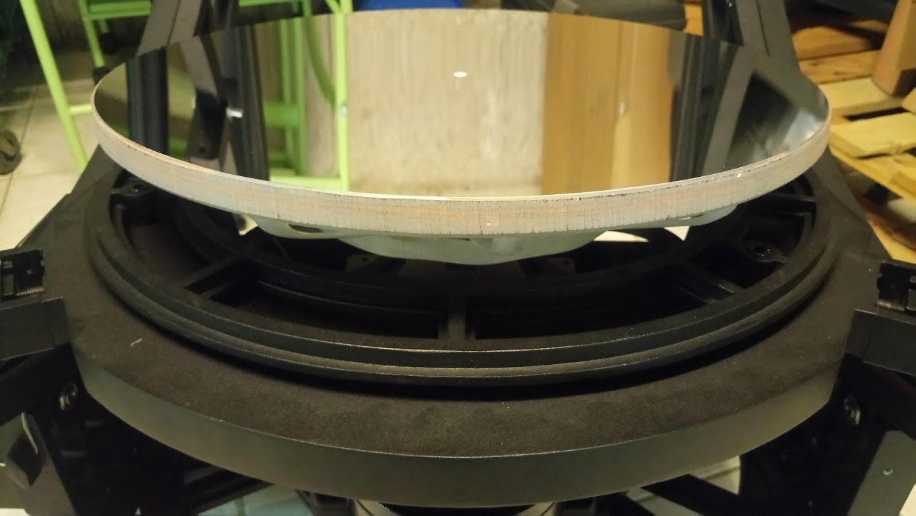

Et le vif du sujet :cool: Est-qu'on a une idée de l'origine de ces tailles verticales sur le champs ?

Ouais, ben ce n'est pas normal, ton problème avec les guides latéraux... Ils sont là pour que les faces des tourillons ne viennent pas frotter le métal. Regarde les photos que j'ai relayées, les guides en plastiques sont bien présents.
Bon, tant que ça reste bien centré, tout va bien, je suppose...
Ah, je remarque à l'instant que les tourillons possèdent une lèvre du côté interne, qui vient se plaquer contre les joues des poulies... C'est clair que ça ne va pas bouger, là, mais ça pourrait user le revêtement avec le temps à cause des frictions métal contre métal.
Tu veux parler des sortes d'encoches à la périphérie ? Un défaut de découpe du blank, apparemment.
Tant que la surface est bonne... Le bord semble chanfreiné dans les règles de toutes façons.
Salut Captain,
Étrange ton histoire de "cales"....
Toutes les photos que j'ai trouvées sur internet, et celles de JBMMV (pages 2 et 3 de ce post), et comme mon 508, conservent ces cales.... :b:
  macfly51 a dit :
Salut Captain,
Salut Macfly. Oui étrange car j'ai aussi fait le tour du net avant de les retirer et on les voit partout. Sauf si un génie sommeille en moi :-) si à l'usage je vois que çà pose problème, je les remettrai en les limant côté face intérieure.
C'est quand même étonnant, cette histoire de rocker plus étroit que la cage du primaire...
Surtout que quand on voit la lèvre le long des tourillons qui vient se caler contre les poulies et qu'on constate sur tes photos qu'ils rasent les bords externes du rocker, on voit bien qu'il n'y a pas de place pour ces guides en nylon...
découpe du verre au jet d'eau, les bons artisans prennent la peine de repasser un coup de meule diamantée sur les bords pour ne pas laisser ces traces, c'est pénible à faire, il faut centrer la pièce au mieux pour juste enlever les stries sans trop réduire le diamètre du miroir.
